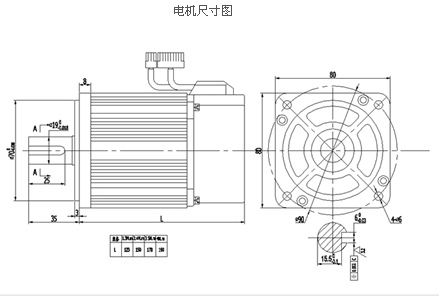

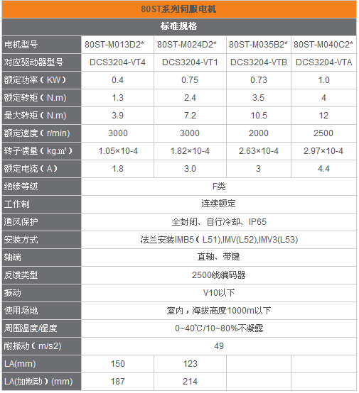

产品说明:
型号:80ST-M013D2*,80ST-M024D2*,80ST-M035B2*,80ST-M040C2*
对应驱动器型号:
3204-VT4,DCS3204-VT1,DCS3204-VTB,DCS3204-VTA
额定功率(KW):0.4,0.75,0.73,1.0
额定转矩(N.m):1.3,2.4,3.5,4
